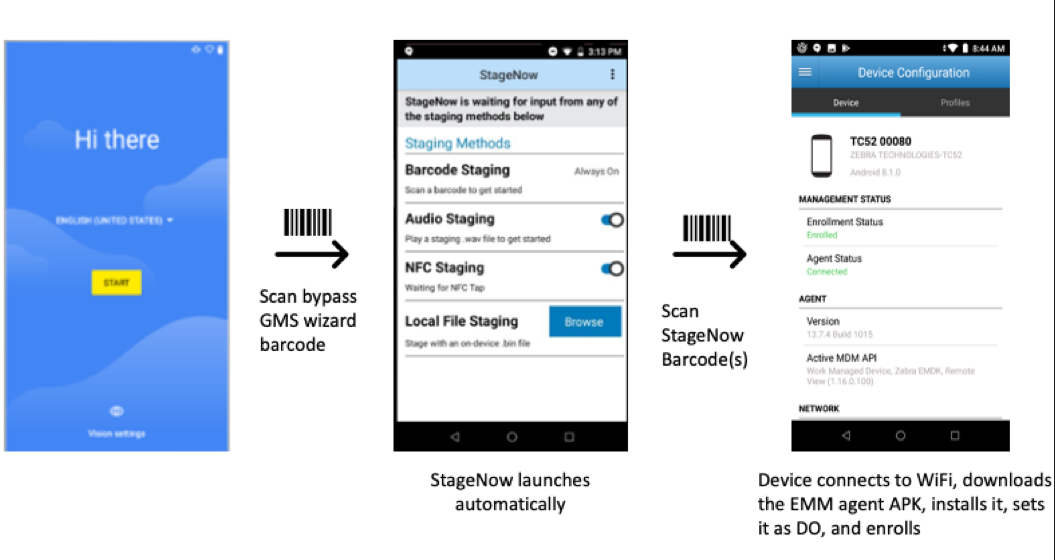

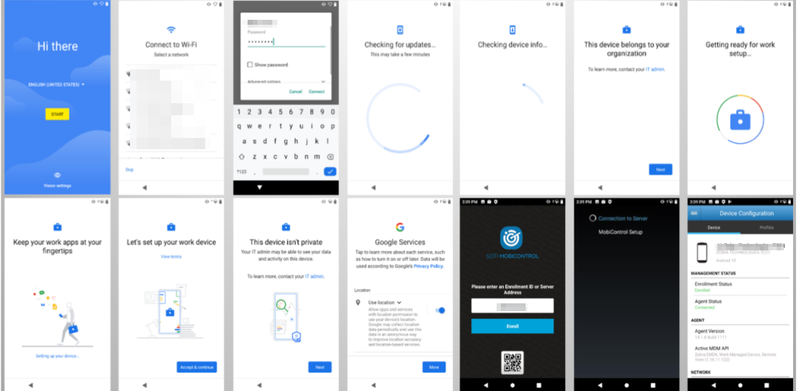

You dont have to use StageNow for Zebra device enrollment in SOTI. You're welcome to try the other default AEDO enrollment methods like DPC Identifier, QR, ZTE, or NFC. You'll find however of all those options, StageNow is the most streamlined and fastest if you're using Zebra devices and SOTI.
Here is "Zero Touch" Enrollment for example on a Wifi only Zebra device. 14 taps minimum, even more for each letter of the password you have to type. Zero Touch is an absolute misnomer. It usually just means Zero Touch for the IT admin as it just puts the enrollment effort into someone else's hands.
Here is the StageNow equivalent. I don't know about you but I'd take Scan+Scan over 14+ taps
