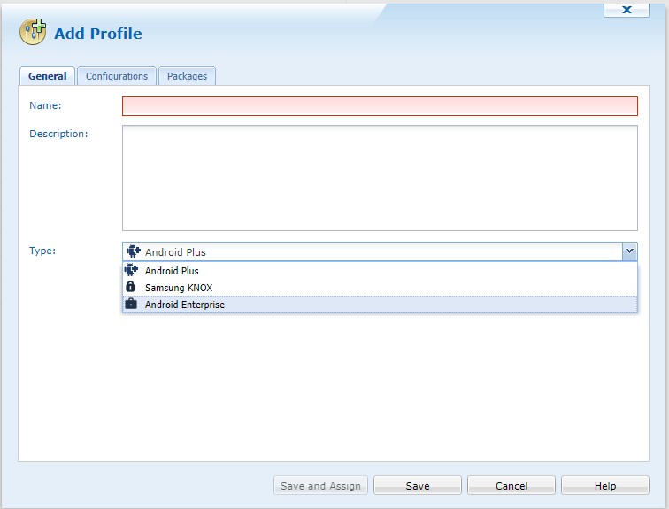

And finally with regards to the profile you assigned to the device, I would assume it was a Android + profile that you assigned with authentication.   I will include a screenshot of this below, if you can confirm that is the case I believe we will be in better standing with being able to assist you.
Profiles type
